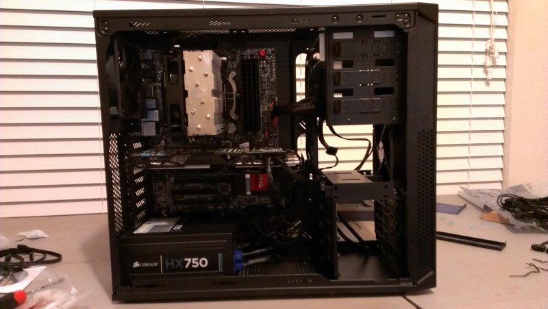

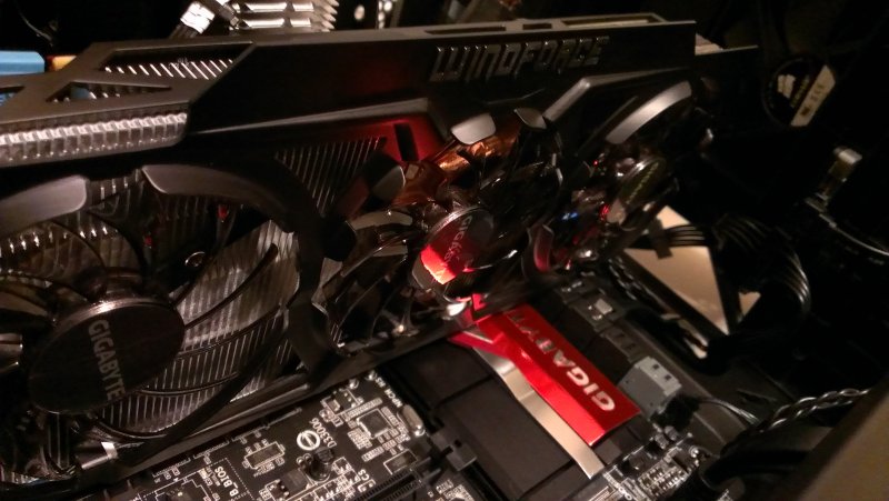

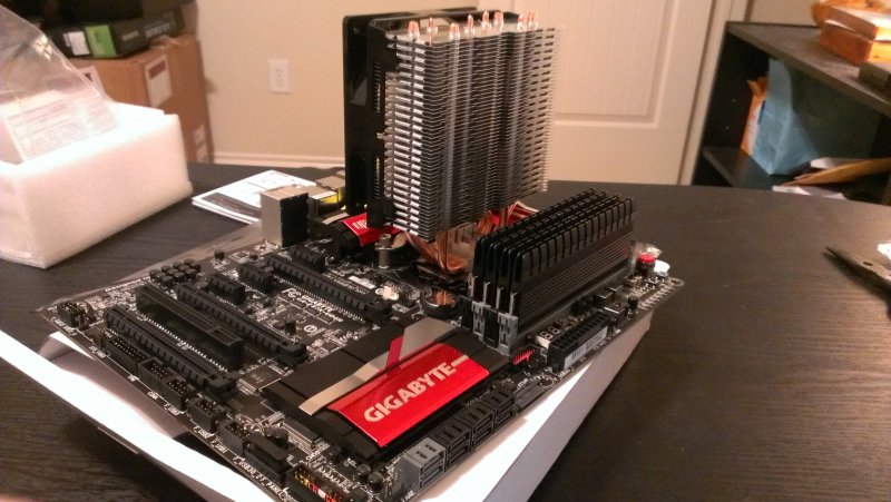

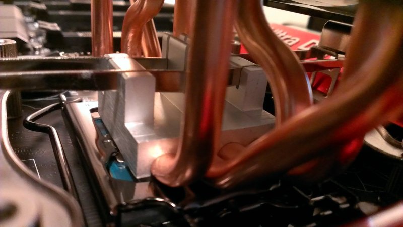

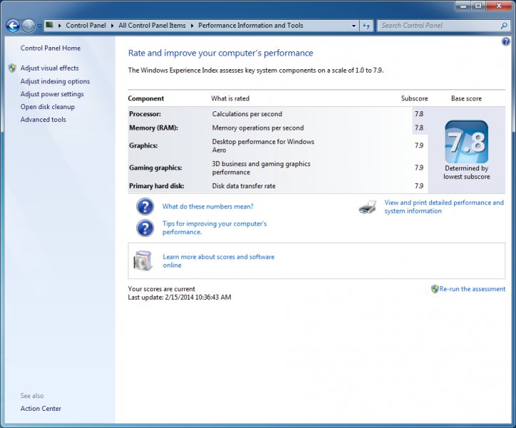

tzframpton Posted February 15, 2014 Posted February 15, 2014 Thought I'd share a build I did yesterday, tested and tuned with Revit and AutoCAD. This thing is fast. To start off, a full spec list of the most important parts: CORSAIR HX Series HX750 750W ATX12V Intel Core i7-4770K Haswell 3.5GHz LGA 1150 GIGABYTE GA-Z87X-UD4H LGA 1150 Intel Z87 Kingston HyperX 3K SH103S3/240G 2.5" 240GB SATA III SSD 32GB RAM Total = Crucial Ballistix Elite 16GB Kit (8GBx2) DDR3 1866 Cooler Master Hyper T4 GIGABYTE GV-N770OC-2GD GeForce GTX 770 2GB 256-Bit GDDR5 PCI Express 3.0 The computer alone, along with a few other miscellaneous parts and case and stuff was $1,775 tax and all. Not too shabby. The guy I built it for also bought two 23" IPS HD monitors.... cheapies but IPS rocks so either way. For those interested, it's the AOC i2369V monitor. For anybody wanting to compare specs for a computer build, this can be a safe benchmark. Windows Index Score was 7.8 overall. Revit and AutoCAD just flies open, and this video card doesn't even get out of its chair to lift a finger until you render something. Tested a few good sized models and the only time it slowed down is when Realistic mode was enabled. Cold boot to Windows 7 Pro being "ready" is 12 seconds, consistently. Tested it four times. The one thing I like about this computer is that it's ultra-quiet. I mean this thing is silent, which is what I was after with the after market Heat Sink and Fan. The PSU fan won't even run if it's not calling for a certain amount of electrical load. The three fans on the video card are extremely silent.... very impressive actually. Case Fans on a $70 Corsair case are dead silent as well. Very satisfied with this build and obviously so is my friend who I built it for. Just thought I'd share so people can use the info for themselves, or ask questions if they want regarding some of the specs. Enjoy the pics too. - Tannar Quote

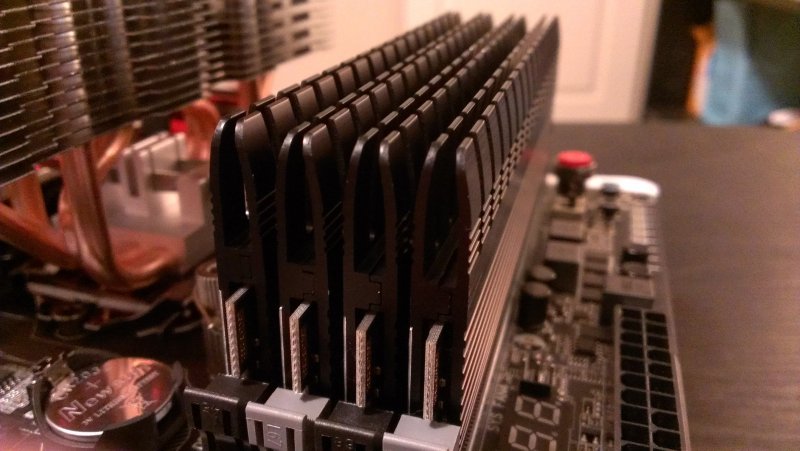

f700es Posted February 15, 2014 Posted February 15, 2014 Huh, cooling fins on the ram. Nice touch. Quote
Dadgad Posted February 16, 2014 Posted February 16, 2014 (edited) Tannar, that is smoking! I am drooling all over my laptop looking at this! The price is very reasonable, I am seriously impressed. I bet it was hard to watch it walk out the door! Edited February 16, 2014 by Dadgad Quote

f700es Posted February 16, 2014 Posted February 16, 2014 So he basically has a game rig for Revit and Cad, correct? Looks like a good solution. Quote
tzframpton Posted February 16, 2014 Author Posted February 16, 2014 So he basically has a game rig for Revit and Cad, correct? Looks like a good solution.For sure. The PC gaming market and Revit/CAD market's hardware needs have migrated to similar configuration hardware setups, other than SLI configurations. Rendering applications are utilizing SLI configurations, but AFAIK not real-time authoring. Gamers definitely do the SLI route, and probably less RAM needs. Quote
f700es Posted February 16, 2014 Posted February 16, 2014 Imho for the money he spent he could not have a Xeon based system near that one's performance. Now spend 5x that amount and sure no problem. Quote
