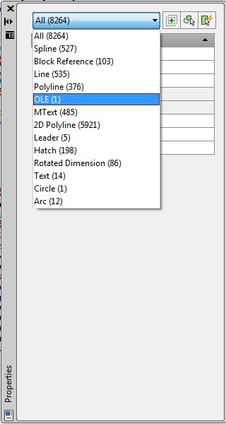

if you want to know if there are any OLE objects in your drawing, do a Ctrl+a to select all and in property box, drop down selection and you can see if there are any, and if yes how many
