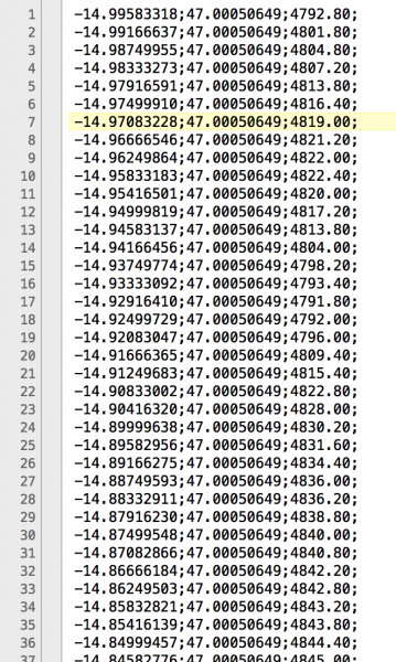

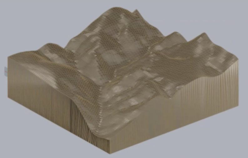

hpnguyen Posted February 17, 2014 Posted February 17, 2014 Dear all, I'm looking to create with Autocad 2013 a bathymetry file (.stl like the one attachment). I have the XYZ file of the region (Longitude, Latitude and Depth Average) in excel or text format. I also have it in Esri ASCII format. It will be so nice if someone can give me the detailed procedure to create the .stl file from the xyz file because I never used Autocad before and I really don't know where to start. Thank you all for your time, I really appreciate that. Quote
hpnguyen Posted February 17, 2014 Author Posted February 17, 2014 I forgot one more precision, the stl file that I need to create must contains only 3D solid elements (not surface). I have the xyz file in the attachment. Quote

Tyke Posted February 18, 2014 Posted February 18, 2014 @ Tiger, bathymetry is a sea bed surface. Is the coordinate list X & Y in decimal degrees and the Z coordinate the depth in metres? You would need to convert the list to all the same units, say metres, and the depths into heights to get the correctly shaped surface then using AutoCAD Civil 3D you can import the points to create a digital terrain model (a surface). If you don't have access to Civil 3D you could use the free CADTools from Glamsens to create the surface. The secret would be converting the coordinate list into an acceptable format, but that would be possible in Excel or a coordinate transformation program. Quote
hpnguyen Posted February 18, 2014 Author Posted February 18, 2014 Thank all for your answer. Yes, I aware that it's not a simple thing for a beginner but for my project, I have to do it in order to obtain a STL file to use with Flow-3D (CFD software). Thank you Tyke for your answer. So X and Y are the longitude and latitude respectively, in "°" degree. And the Z correspond to the depth in "m" meter. I have upload the txt file: http://www.mediafire.com/download/0gyavv7qf9v3zxw/data5.txt.zip So can you explain me how I can convert X,Y and Z into the same unit by using Excel or something else (in meter)? Once I'll do it, I will use Civil 3D (trial version) as you explained me. But can I get the STL file from Civil 3D? Because with Autocad, the command STLout can only be used with solid body, and not with surface?? Thank you very much. Quote
