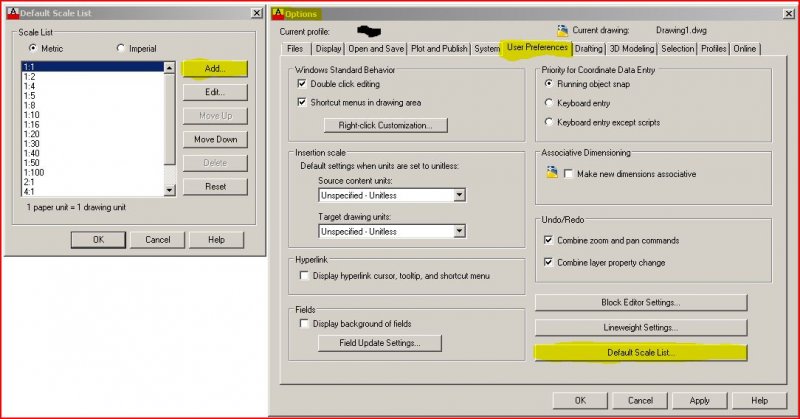

Should you want to, you could also create your own personal custom-bloated default scale list, thus ensuring that you have a better default range of selections available, and saved in your Profile, so that you always have them ready should you need them. You can also delete any that you feel are uncalled for.

Dadgad- woooahhh, I never knew there was a way to permanently add to the Scales list across all my files! Awesome!
For this specific case I don't need exact Scales, which is why I would just hope to use a messier, easier solution. But I will keep this in mind!
