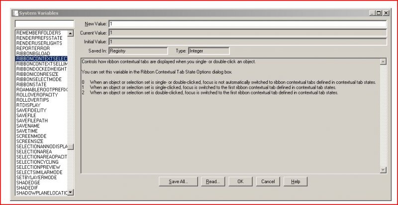

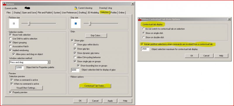

Dadgad Posted February 21, 2014 Posted February 21, 2014 You might want to look at the RIBBONCONTEXTSELECT variable, as referenced in the attached images. Quote
