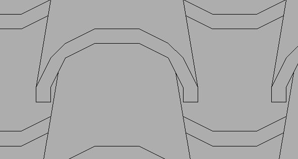

eldon Posted February 24, 2014 Posted February 24, 2014 These ain't straight. I am not sure what you are referring to, but this is a detail from your posted drawing. Definitely straight lines. You have only to look at the definition file to see. Quote

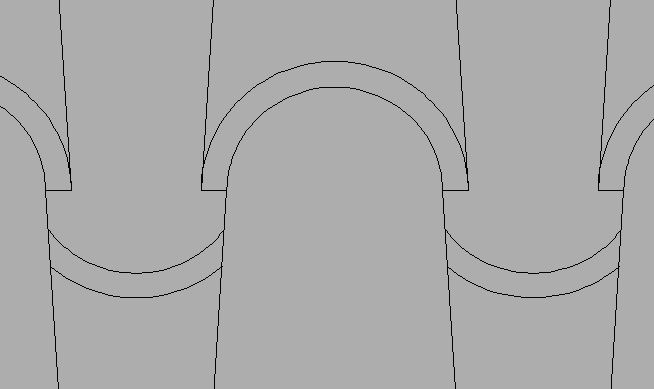

eldon Posted February 24, 2014 Posted February 24, 2014 And here is a snippet from the OP's drawing. Curved lines (part ellipses) and straight lines. Quote
