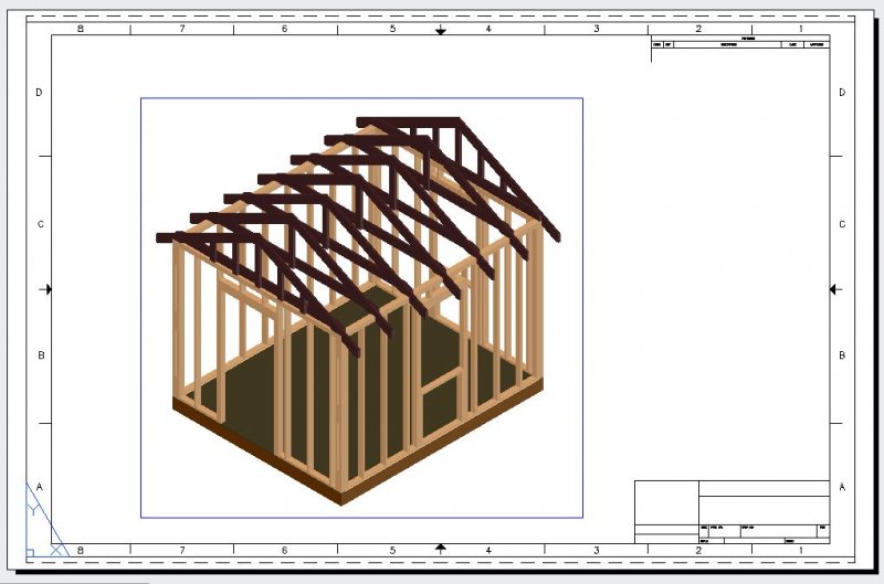

ReMark Posted March 3, 2014 Posted March 3, 2014 Example of a title block and border in a paper space layout with a single viewport showing a 3D model of a wood framed shed in a southeast isometric view. The viewport is the blue rectangle seen surrounding the shed. It is on its own layer which is set to "no print" meaning it won't be seen when the drawing is printed. The viewport display has been locked so its scale will not be inadvertently changed. Quote

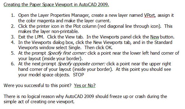

cmarvel Posted March 4, 2014 Author Posted March 4, 2014 I spent 3 hours trying to get MVIEW to work over the weekend. Couldn't get past square one or two without the session aborting and / or freezing. I hope your expertise will be of assistance to others on the Forum. Please do not respond to my posts in the future. Quote
ReMark Posted March 4, 2014 Posted March 4, 2014 (edited) So I am responsible for your failure to get MVIEW to work? That's a hoot. Is there no MVIEW command in AutoCAD 2009? Is that the problem? If so, see the next post for an alternate method. Were you in a paper space layout when you invoked the command? Start the MVIEW command and look at the command line. AutoCAD is asking you to specify corner of viewport or... then it gives you a series of option. All you need to is ignore the option and draw your own viewport by specifying the lower left hand corner of your viewport then the upper right hand corner. That's it. Don't worry about size as you can resize a viewport using its grips after the fact. Everything you need to know about paper space viewports and then some....http://www.cadtutor.net/forum/showthread.php?72972-Things-you-should-know-about-Viewports.&highlight=paperspace+viewports Edited March 4, 2014 by ReMark Quote
