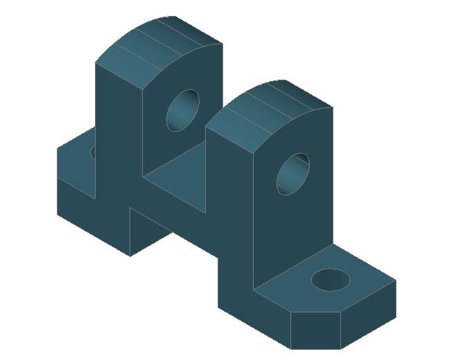

ReMark Posted March 3, 2014 Posted March 3, 2014 Is this the rod support you are supposed to draw? Mine might be slightly different than yours as I found this version in a different book than the one you mentioned. I'm guessing your assignment is to draw the top, front and side views. Is that correct? Quote

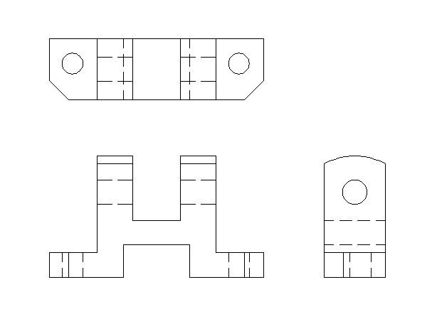

ReMark Posted March 3, 2014 Posted March 3, 2014 (edited) Stop what you are doing on CAD. Grab a blank sheet of paper and a pencil. Now, looking at the isometric view of the rod holder freehand sketch on your paper what the top, front and side views. If part of the view is block substitute dashed lines for solid lines. Use this quick sketch and the dimensions provided by the diagram in your book and transfer what you drew to CAD. The top view is basically a rectangle with cut (chamfered) corners at the front. There will be holes in the horizontal legs. There will be dashed lines to represent the opening at the bottom and the holes that penetrate the vertical legs. The front view will look like back-to-back capital letter "L's" with a horizontal bar between them. Dashed lines will be needed to represent the holes that penetrate the horizontal and vertical legs. The side view is basically a rectangle with a slightly curved top and a hole in it. Dashed lines will be needed to represent the hole in the horizontal leg that extends towards you. Make sure to account for the presence of the chamfered corner in all three views too. Edited March 3, 2014 by ReMark Quote
ReMark Posted March 3, 2014 Posted March 3, 2014 You should be done by now. This is what I came up with. Quote

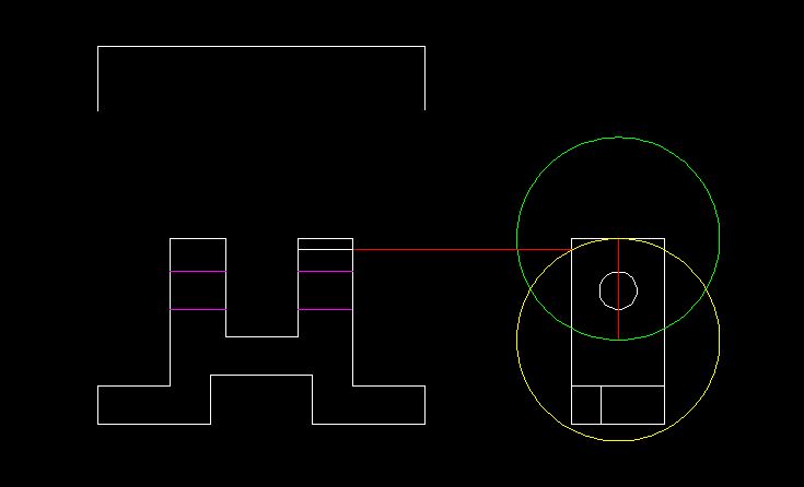

fishwater71 Posted March 3, 2014 Author Posted March 3, 2014 I think this got it. rod support pg 274.dwg Quote
ReMark Posted March 3, 2014 Posted March 3, 2014 Hint. In your side view locate the centerpoint of the arc (radius=35). When you find it draw a circle with the same radius. Where the circle intersects the left hand side of the rod support draw a temporary construction line over to your front view. That will be the start point for the height of the vertical leg. Remember that a little bit of the vertical leg will show above this point as this is where the arched portion of the support is located. Please double check your dimensions and make sure they agree with the diagram. Quote
ReMark Posted March 3, 2014 Posted March 3, 2014 The magenta lines should be dashed. I've got to go out into the plant for an hour or so. You should be all finished by then with laying these views out. Quote
fishwater71 Posted March 3, 2014 Author Posted March 3, 2014 [ATTACH=CONFIG]47240[/ATTACH]The magenta lines should be dashed. I've got to go out into the plant for an hour or so. You should be all finished by then with laying these views out. This will be close enough to go to the teacher with and ask her a few things for clean-up and turn in. Thank you very much. I have some others I m working on to. rod support pg 274.dwg Quote
