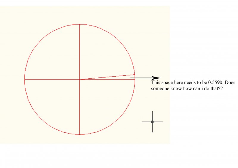

i made a circle because i am trying to make an auditorium and i am trying to find 0.5590 degrees but i can not...
basicaly i need to divide the circle into eaqual pieces Please have a look in the image. Does someone know how can i do that??

First set your angle precision to four decimal places in UNITS.
Then draw a line equal to the radius of your circle at an angle of 0.5590 which can be done via the command line. In the example below the length of the line representing the radius is 2. Type the input exactly as shown.
Command: Line
Specify first point: cen (for center of circle)
Specify next point or [undo]: @2.0
I tried but I had no result maybe because I do not know how to draw @ point. Is there any other way that I can make the angle without the @point??
Once you have your precision set high enough, you can polar array your circle into equal chunks. Even at a 100 foot radius this angle is only going to give you about 12" between points on the circumference of the circle.
