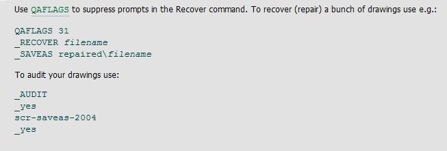

Found this. Maybe it will help?
This is wierd. I set QAFLAGS=31 and ran the following script
recover
"p:\Design_Office\India Test\RecoverHere\P1US210068-09-MD-0005-01.dwg"
resume
qsave
recover
"p:\Design_Office\India Test\RecoverHere\P1US210068-09-PD-0001-01.dwg"
resume
qsave
recover
"p:\Design_Office\India Test\RecoverHere\P1US210068-09-PD-0001-02.dwg"
resume
qsave
recover
"p:\Design_Office\India Test\RecoverHere\P1US210068-09-PD-0001-03.dwg"
resume
qsave
recover
"p:\Design_Office\India Test\RecoverHere\P1US210068-09-WD-0001-01.dwg"
resume
qsave
resume
which changed the errors present from 299 to 435.
I ran the script a second and the errors reported started at 299 again and all were fixed!
It looks like I may have a solution but still no nearer understanding the problem. Oh well.
