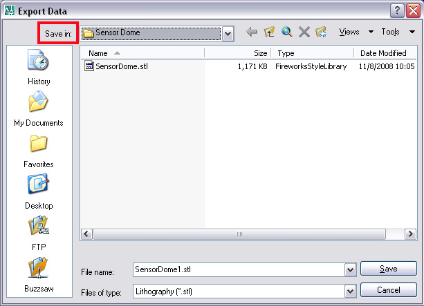

Cad64 Posted December 2, 2008 Posted December 2, 2008 Your Autocad model will not change. What you are doing is Exporting your model out to an .stl file which will be saved somewhere on your computer. Check your "Save In" location for an .stl file. Quote
