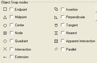

The box symbol is for an ENDPOINT, and a triangle is for a MIDPOINT.
Unless you are seeing a cross, then you are not picking up the Intersection point, as your tooltip will be telling you.
I was trying to find a picture of all the Osnap markers, but, as usual with the Help files, it is buried somewhere.
Here they are, to the left of each Osnap. (right under my nose)
