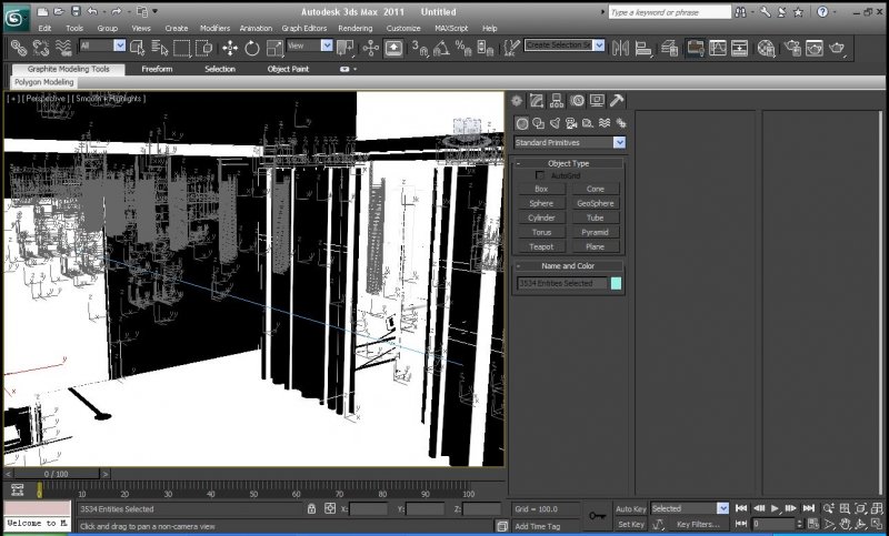

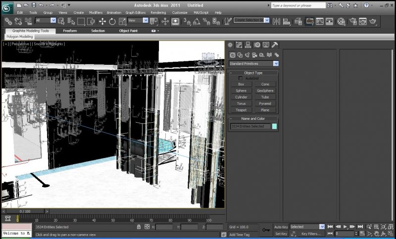

I d/l a model of a hospital ward from 3D warehouse and I I tried selecting all of its objects and using material editor to make all objects in model the default gray but it didn't work - here's what the model looks like (see image):
--second, what are those gray things that look like they're hanging from the ceiling/upper part of the model/do I really need them (appears as gray overlay)?

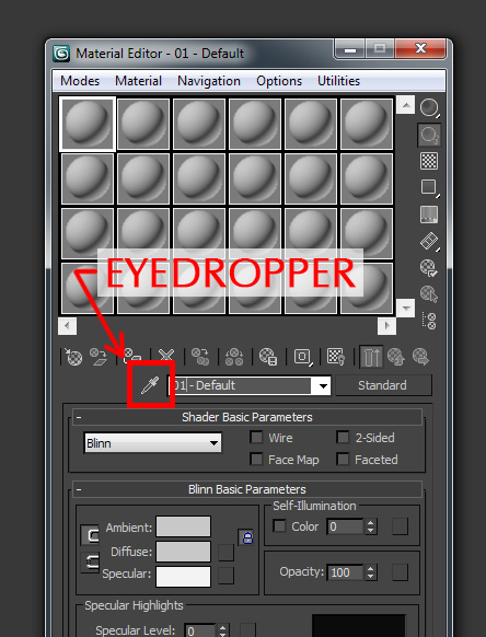

If I had to guess, I would have to say that there are probably materials applied to those objects that won't change to the default gray. Open the material editor, select an empty material slot, click on the little eyedropper tool and then click on one of the objects that will not change to gray. If there is a material applied to the object, you will see it appear in the empty material slot.
I have no idea what those things are. That's one of the issues you have to deal with when using a model built by someone else. You will have to figure out what those things are and decide if you need them or not.
