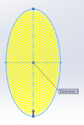

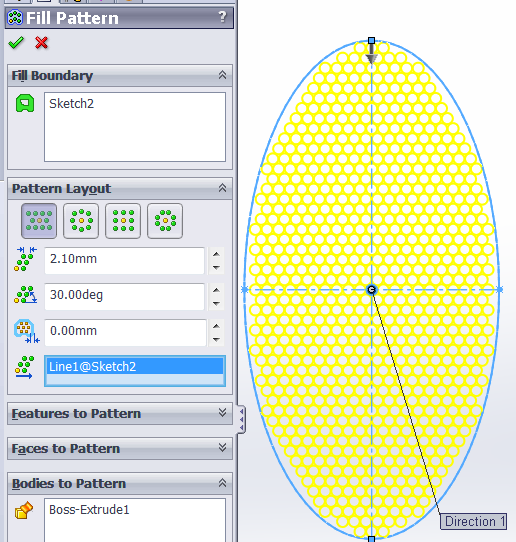

Something like this?
Can you describe your design intent in detail?
or this? Oops, I missed the 4mm part of the problem description. These are spaced 2.1mm
[ATTACH=CONFIG]47440[/ATTACH]
Was that done in Autocad? Looks like Solidworks to me. I fail to see how this is helpful to the OP who is using Autocad.
Are you familiar with Divide or Measure in AutoCAD?

Is there something similar to the 'Fill Pattern' command you've used above in AutoCAD? I thought fitting an array or pattern to a face would be an obvious command / option for AutoCAD.
NB - I have completed the perforations by arraying in a square pattern, mirroring to cover the whole ellipse shape, exploding to individual units, deleting the cylinders I don't want, moving in the -ve Z direction and subtracting. Although this works I'm hoping there is a quicker method to save time in the future. See screenshot below.
