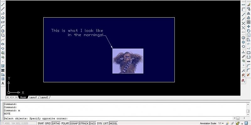

soleary Posted December 5, 2008 Posted December 5, 2008 All of my drawings that I have done have been done on the model tab. I haven't used layout1 or layout2, I don't actually know what those tabs do other when I select them it gives me a differnt screen. Are you selecting everything or just the image? You will need to use the move command and then when it says 'select objects' put a window around everything (see image). Then move them all to where you want them. PS you should learn what those layouts do Quote
