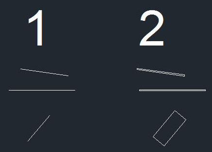

I have hundreds of lines with different length and need to change each to a rectangular with the same length and a specified width. Is there any way to do that for all easily?
Would the width going to be the same as the length of each line or it should be given from a user ?
Would want to delete the selected lines after the process ?
can you upload a sample drawing ?
The length of each rectangular is the same the primitive line or pline but the width specifies by user. The resulting rectangular middle center is coincident to line middle point. Then delete first line. I'm new to here and don't know where can I upload files. Thanks for taking time brother Tharwat

Would there be an arc segment? if YES, look into Lee Macs Polyline Outline routine.
I don't have any arc in my drawings but may be some one else has one. You know this app can be used in structural shop drawings widely. You can assume all are lines and there is no polygons.

we just have some lines as u see in case 1 and want to change them to case 2 relate to their center point.

Try this:

THANKSSSSSSSS pBe. Youre genius man. How can I do in return? May I deposit money?

Editing width by pedit just change the visibility of line but the code pBe wrote reshapes a line to a rectangle which help user to draw more details based on rectangular's edges and sides by snap mode solutions.
