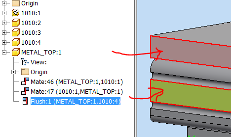

I am trying to place a table top on a frame I assembled. The edges on the frame have a fillet. I have been able to get 2 of the 3 constraints using the flat cut ends, but the last needs to be constrained to the fillet edge.

Forget the fillets - they are irrelevant.
Mate - Flush the planar side (vertical) of the table top to the planar side (vertical) of the frame member.

Thank you very much! That worked perfectly. I will check my update status when I get home.
