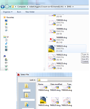

I had to reinstall AutoCad 2014 after the reinstall when I save a drawing the it no longer shows the drawing as an icon only the dwg icon.
I have gone into tools and checked the thumbnail settings, reset my proflie, checked the windows folder settings and also checked if the reg key (d-word was set to 1). Explorer also shows only the Icon. The preview window does show the preview.
Note only newly saved files shows only the icon.

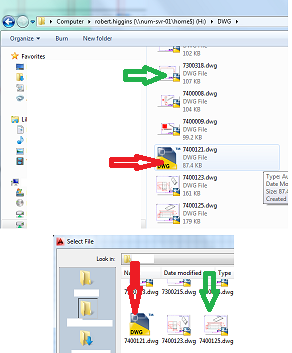

YES I did try to reassociate. and as you can see in the pic below the red arrow is what I get after I save a drawing and the green arrow is what the others look like. This being the case the options: List, Details and Thumbnails is set correctly (although I did try other settings).
I know it seems that all the fixes I have found refers to the preview windows. I have looked for the past 3 days not doing one drawing to see if I could find the answer. No luck.
I has really got me confused about what I thought I knew about AutoCad and Windows. I have also posted on AutoDesk with No replies.

Hay ReMark I got it. OR should I say you got it some of it.
Another AutoCad Forum said to associate the dwg files to any other program then reassociate it to the AutoCad again and it worked.
Another mystery solved. Glad to hear it and thanks for sharing the solution with us.
