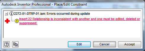

Does anyone know how to disable the pop-up window for constraint errors posted below. It frequently comes up when I've drastically modified a part in an assembly and constraints and/or adaptive parts become sick. I am well aware when this happens as the Red Cross turns on, as well as just being aware of how my assembly is set up. I know I have to go through and re-define the constraints, etc. Inventor oh so helpfully informs me of this by making me click through the stupid dialog box for every single constraint. Can it be turned off? Thanks!

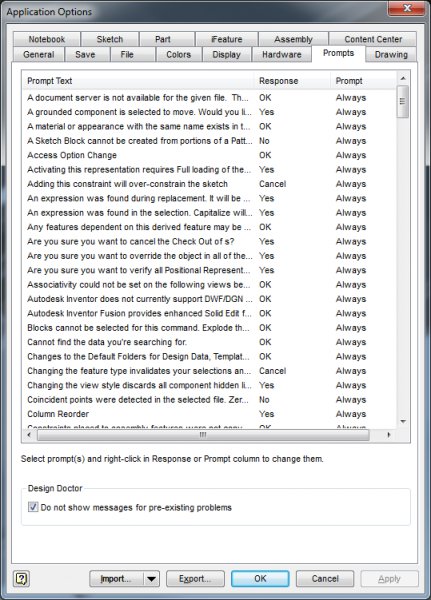

Never mind! A co-worker found a toggle under Application Options. See screenshot below, toggle ON the "Do not show messages for preexisting conditions" under Design Doctor on "Prompt" tab of Application options.
