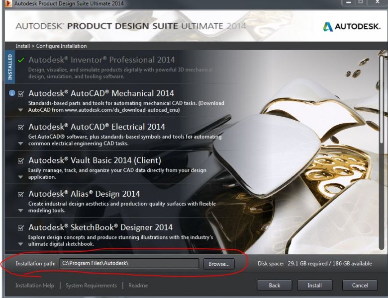

Vagulus Posted March 30, 2014 Posted March 30, 2014 I am a bit tight for space on 'C' drive but I have tons of room on 'E'. I tried installing Inventor Student Edition on 'E' but the installer put a large amount of the program on 'C' anyway. Is there any way I can install the application only on 'E' Drive? Quote

JD Mather Posted March 30, 2014 Posted March 30, 2014 I don't think you need anything at C:\Autodesk This is commonly where the download install files are automatically extracted to. (think of these like a removable DVD) You can move them to anywhere you want. (in fact I recommend that you burn a back-up as the download process takes a long time if you ever have to repeat) Start the setup.exe and the program will be (must be) installed to C:\Programs Files\Autodesk and a couple of other locations. I see a lot of people with the "program" on their machines 3 times. 1. The compressed download 2. The extracted install files 3. The installed program files. 1 and 2 are not required on the boot disk. Quote

JD Mather Posted March 31, 2014 Posted March 31, 2014 (edited) Compressed download files (these can be anywhere). These can be deleted after extraction. Folder containing the install files (this is essentially the same as a DVD) can be anywhere - but typically default extraction to C:\Autodesk These can be deleted after installation complete. The actual required files C:\Program Files\Autodesk\Inventor 2014 So the actual install is less than 4 Gig. (without Content Center) This is for Inventor Professional - you size might be different. If you choose to install Content Center - there are some additional files installed in another location. Edited March 31, 2014 by JD Mather Quote

Vagulus Posted March 31, 2014 Author Posted March 31, 2014 This folder is in C:\Autodesk Autodesk_Inventor_2014_Eng_64bit_wi_en-US 52.5MB This folder is in C:\Autodesk\WI Autodesk Inventor 2014 8.12 GB These are in E:\Program Files\Autodesk\ Inventor 2014 2.86GB Autodesk 144MB Autodesk ReCap 144MB Vault Basic 2014 310MB Quote
Bishop Posted March 31, 2014 Posted March 31, 2014 Yes, you can install Inventor to a location other than your boot drive. It will not, however, install EVERYTHING to that other drive. There are certain components and files that will always be installed to the boot drive. Quote
