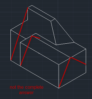

can someone verify my work if this looks correct?
No, I'm afraid that isometric sketch is wrong! Please pay attention that there were many sloped faces, not just one.
Mikeyyy, please edit your previous post and up-load the pictures on CADTutor; as already pointed in your previous thread, the third-part repository you used may not be accessible for some people that will be willing to provide help to you.
There are sloping lines you aren't accounting for, see attached for a partial correction of your post.
