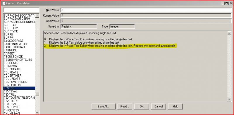

looking at the SYSVDLG window, might you want to try setting it to 0 instead?
If you now, with it working as you like, call the TEXTED command, what does it say your current setting is?

I did experiment with the 3 different TEXTED options before resetting ACAD...
- Options 0 and 2 behaved itendically - double click would initiate the DDEDIT command, then we still had to click a third time to select the text and edit it - the in-place text editor was then initiated. The DDEDIT command would loop/repeat regardless of the TEXTED variable being set to 0 or 2, which I found strange.
- Option 1 - double click would initiate the DDEDIT command, then we still had to click a third time to select the text and edit it - the text edit dialogue box was then initiated.
We currently have the TEXTED variable set to 1 (bringing up the dialogue box). I prefer this method because it just seems a little bit smoother/quicker to access the dialogue box rather than the in-place editor (maybe just because that is what I am used to).

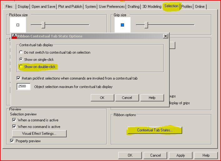

One of the few places where I know you can change clicking behavior in the OPTIONS,
which would seem to have absolutely nothing to do with your problem, but might anyway?
Take a look at the image, probably won't help, but, heh?
This was the reason I asked if you were using the Ribbon, or, like myself, the toolbars.

I just tested changing that Ribbon Tab State option, and I could not notice any changes (I think that is due to the fact that I use only toolbars).
