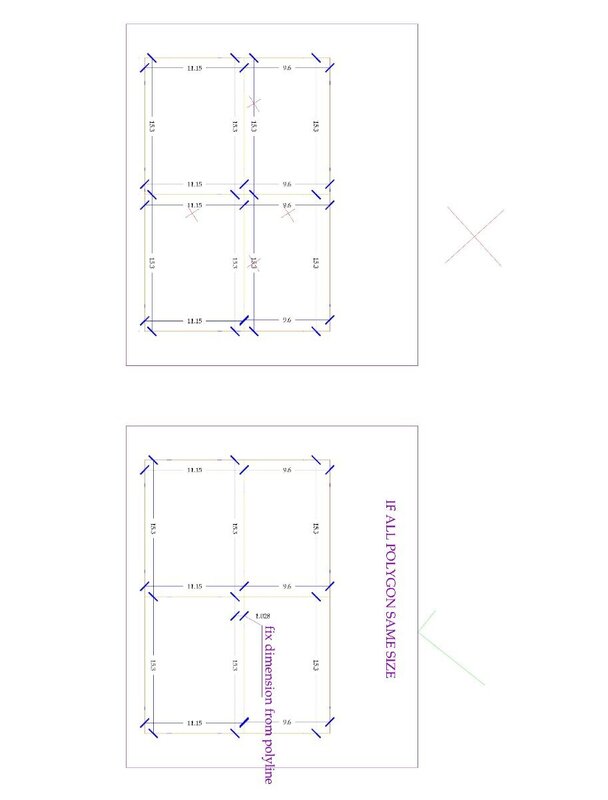

Pdim.thumb.jpg.c64d843b29b8479b6ef4dbba24be4df6.jpgplease rewrite above lisp code add with
1. associate dimension style
2. Outside or inside option
3. remove duplicate  dimension create by two or more adjacent close polyline (same size)
Edited by maahee
1. What are your skills with LISPs like, if I give you a link will that help you out?
A simple internet search pulls up this thread (https://forums.autodesk.com/t5/visual-lisp-autolisp-and-general/lisp-and-associative-dimensions/td-p/2185589#:~:text=They can be associated but the process is,of line%3A ")) (command "line" a b "")) - to show that adding "end" in the line (command "_.dimaligned" (car vLst)  (cadr vLst) cPt) will work:
(command "_.dimaligned" "end" (car vLst) "end" (cadr vLst) cPt)
2. The LISP asks this
3. will need some more information - how 'close' do the dimensions need to be?
distance between dimension line to polyline is equal to height of dimension text
