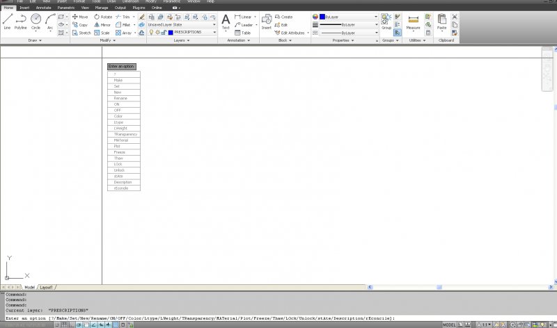

Hi you all,
I have a problem with layer properties, and some other windows that don't open but show this kind of selection.
I tried a lot of codes that I saw in forums, but they didn't work.
Can you help me please?
What do you mean you "tried a lot of codes"? Where you attempting to customize your setup?
If you mean that you don't want the list next to your mouse, that is controlled with Dynamic Input, You can toggle it off with f12 or at the DYN-button at the bottom left of your screen.
Hi! First thank you for your helps.
Then, I mean that I would like to see all the layers in the window, and not select the options. F12 put away that menu but the window doesn't appear.
Same problem for things like new hatch and so on
ps: the codes that I tried are some commands that I found in forums. But no solution yet.

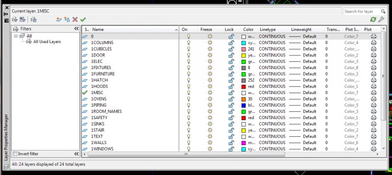

You want to see all your layers in a window? Are you talking about the Layer Properties Manager?
The F12 key functions as Tiger said. Do you want to assign a different command to that key?
Hatch? You don't see a window when you start the command?
What "codes" are you referring to? Are you talking about system variables like FILEDIA?
This is what the Layer Properties Manager window looks like when it is open. Is this what you were referring to?

Could it be that the windows open off screen? Try changing your Workspace (the cogwheel at the bottom right) to reset the look and see if your windows re-appear.
thank you all again.
No it is not a problem of workspace and I think ReMark met the point. I want to see the windows.
I tried variables as Filedia, but it didn't work changing them.
I tried also with right click on ribbon, but it is all already selected.
