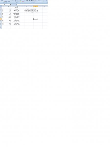

I'm looking for a way to draw a polyline from a text file data. Unfortunately, I can not find any way.
In my text file data: there are 3 columns,
1st column is the point name
2nd column is X coordinates
3rd column is Y coordinates
The first row is the coordinate of the first point, but from the second to last rows
are the relative distances between two alternative points.
Thanks a lot for your help!
Book1.txt
You may build a script from your file; below is an example for 4 of your points:
_PLINE
775,0
@20,200
@-595,1
@0,1980
;end of file
Save the file with SCR extension and call SCRIPT command to process it. May use Excel (or other worksheet processor) to speed-up the editing.
Bring it into excel and use the concatenate option to create a new column as MSasu has shown above then very simply just copy the column and paste to the command line.

I actually thought after I posted I bet you have multiple plines you want to do. A simple question is A & B to use the as given start points or do you want to just place the shapes next to each other if so you only need to change the excel code to have a x & y offset.
I will redo the excel twice and paste it this time, to me its a real quick soulution.

^o^. I got it. it works when I disable "Osnap" by pressing F3 as Msasu said!
