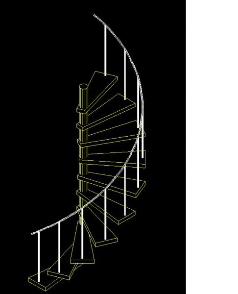

Try this, think about it in 3d draw 1 step as a block, 1 cage ring as block, just work out the vertical spacings, insert at a known pt say left pt of ladder and just do a vertical move, (MOVE L "" 0,0,0 0,0,z) just repeat for the number of steps make sure your osmode is 0. A full 3d spiral stair is a "splat" all done because the stair is made up of individual 3d treads & hand rail just inserted moved and rotated.
If inclined set ucs first to correct plane.

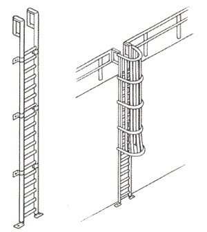

BIGAL, I think that OP is looking for something like this:
ROBP, it would be also useful to learn if you want a 2D or 3D result.
[ATTACH=CONFIG]47899[/ATTACH]
Yes MSASU the one i am looking for is in 2d and the one on the right hand side in the picture

Theres a bit in it but its achievable its a case of set the rules ht from ground to 1st floor divide by a rung height etc works out spacing then draw rungs, hand rails extend an amount above 1st floor draw from ground, the cage again a set of rules.
i
The real question you say 2d but is that plan & 2 elevations ? That is 3 different lisps. Me personally I would still do it in 3d but as parts joined together = plan, 2 elev's & a 3D
