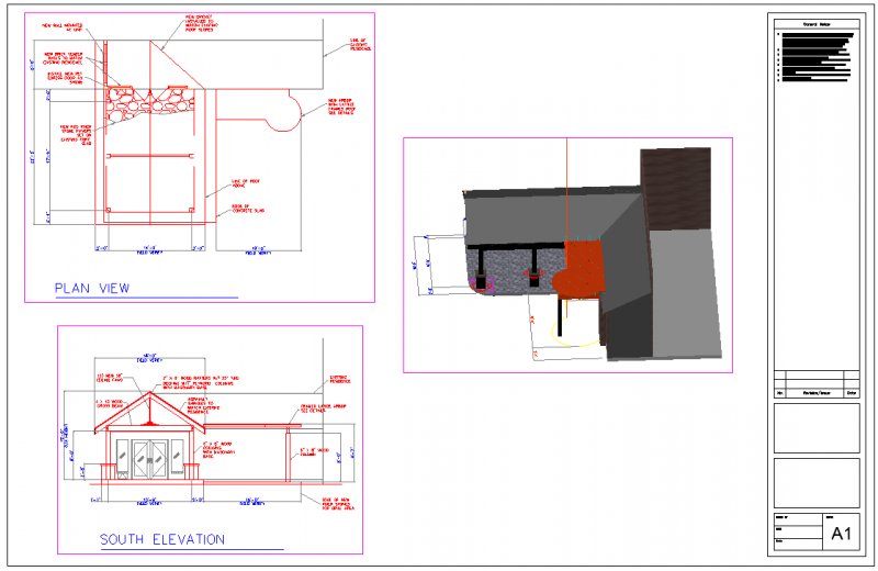

Bill Tillman Posted April 6, 2014 Posted April 6, 2014 I have a drawing I made in model space with both 2D and 3D details. I seem to have two problems with this. In working with the 3D details I often set the ShadeView to Realistic to see what it's going to look like. Now each time I save the drawing it resets to Realistic shadeview, when I need it to stay in 2DWireFrame. The real problem though is that no matter what I try with viewports in the layout tabs, I cannot set the scale for the viewport. I set it to 1/4"=1'-0" and it immediately resets to Custom. The size of the objects in the viewport do not change size as planned and I'm stuck with Custom Scale. The viewports are not locked and even if I create new ones, I end up with the same problem. Quote

Bill Tillman Posted April 7, 2014 Author Posted April 7, 2014 Thanks everyone. Here is the drawing file in question. I have several layout tabs in use and on only one of them do I not have this problem. The TitleSheet layout tab is fine, but the others exhibit this problem. When I add a new viewport to these tabs, it's impossible to set the scale for the new viewport. I have honestly never encountered this before. CustomScaleProblem.dwg Quote

ReMark Posted April 7, 2014 Posted April 7, 2014 Bill: I have the front elevation on layout A1 sitting there right now with a scale of 1/4"=1'-0" assigned to the viewport. Is that what you wanted checked? OK...I've added a new viewport to show the plan view. It too has a scale of 1/4"=1'-0". BTW...I'm a bit taken back by the fact that several of your assigned layer colors have been overridden. Is that a standard practice at your company? Now I have added a new viewport and have it showing a 3D perspective view of your model. It too has a scale of 1/4"=1'-0". I think I'm done here. Quote
Bill Tillman Posted April 7, 2014 Author Posted April 7, 2014 Thanks ReMark, this is a template that I've worked with in the past. I can't answer your question on the color changes without reviewing it further. But if you're able to place a new viewport on Layout Tab A1, and then set it to a scale of 1/4"=1'-0", then you're a better man than me. I cannot get anything set into this layout tab to hold a scale. No matter what I do, it goes back to Custom Scale as soon as I click leave the setting. What I have done is to start a new drawing from scratch and I copied and pasted everything over. It's working fine in the new drawing. Not sure what's up, but the trouble is the client want's his drawings yesterday so I'm going to have to revisit this issue after I submit. Quote
