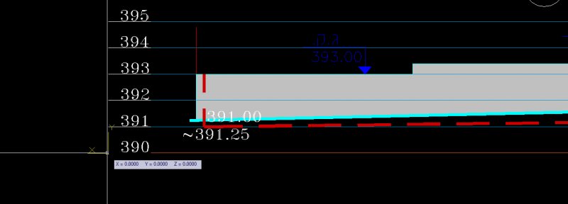

samifox Posted April 16, 2014 Posted April 16, 2014 hi i want to define 0,0,0 coordinate as 0,390,0. i have elevation view with specific levels values, i want to match it with the ucs so when i acquire a point with "id" i'll get the value i see in the label. one way to do so is , if my elevation is 390 , i should move my geometry to the ucs 0,390,0 , how to do it other way around? how to set the ucs to 0,390,0 without moving the geometry? Thanks S Quote

samifox Posted April 16, 2014 Author Posted April 16, 2014 hi as you see , i type "ucs" and than i click the 390 point, now the 0,0,0 of the drawing is actually the 390. i want the xyz to read 0.390.0 when im on that point and not 0,0,0 thanks S Quote

samifox Posted April 16, 2014 Author Posted April 16, 2014 here you go if i exe "id" on the point of 390, i want to see x=? y=390 z=? samifox.dwg Quote

samifox Posted April 16, 2014 Author Posted April 16, 2014 ok i set the origin to that point aster that i enter ucs 0,390,0 the id shows 0,-390,0 why is that? Quote

samifox Posted April 17, 2014 Author Posted April 17, 2014 hi im a constructor, so i get the dwg from the architect, i really dont want to change anything in his structure because this file is subject to updates. what steven offers is good, but for some reason i get negative value $ucs i click in the point of my elevation label $ enter enter $ucs 0.390.0 enter when i lay on the 390 point, the coordinate system reads 0.-390.0 any idea why? thanks Shay Quote
nextvkin Posted April 23, 2014 Posted April 23, 2014 Offset the line that you want to see as x=0, y= 390,z=0 by -390, use that line to create your ucs. When you id the original line it'll show as what you want. Quote
steven-g Posted April 23, 2014 Posted April 23, 2014 Indeed I was joking, from your drawing it looks like you need to have the ucs set at different points, depending on the section you are using, I would type "UCS" then pick your base point (the 390 reference line, at its X=0 point), press enter to accept the ucs orientation, and then type "UCS" again this time type 0,-390,0 which will move the origin point to your zero point for that elevation, from there you can draw your lines as though starting from 0,0,0. Quote

steven-g Posted April 23, 2014 Posted April 23, 2014 $ucs i click in the point of my elevation label $ enter enter $ucs 0.390.0 enter OK try ucs click in the point of your elevation label enter enter ucs 0,-390,0 enter or ucs from (type the word "from", before picking a point) click in the point of your elevation label (move the mouse downwards in the negative Y direction then type 390) enter Quote
