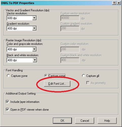

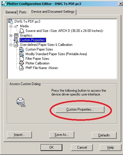

If the layer settings are not the problem, you need to check the properties of your DWG to PDF plotter if that is the one you are using. Make sure the font you are using is selected.

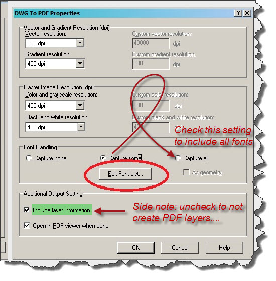

If you do change the "Custom properties" as SLW210 has suggested, i would suggest to change the setting to "Capture all" fonts so that you don't have to select them from a list and then while you are in there, also turn off the "Include Layer information" as well.
