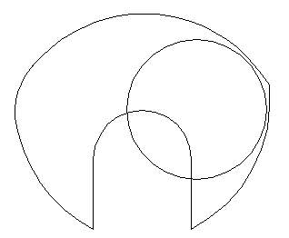

I need to learn to snap two or three arcs together for blending purposes. I draw cams and this is a must. I enclose a screen shot to demonstrate what I am looking for. I have blended the arcs together on the left hand side, by eye, (rather badly) and if you look at the right hand side you will see what I am trying to do.

Mightn't circles using the TTR (tangent tangent radius) option give you a nice transition from one arc to the next,
after which you could use the TRIM command to remove what was not required, then PEDIT JOIN them?
Or even Fillet, with a suitable blending radius.
Better yet, and much quicker! :beer:
Just want to throw in my two cents, and a heads-up too... I have found that FILLETing can sometimes fail between two curves if the curves are part of a polyline. So if you are finding that you cannot FILLET 2 curves, try exploding them out of the polyline, then you can re-join the polyline after filleting.
"Old school" method would be to offset each object by the desired radius and then use the intersection as the centerpoint for the arc/circle. CIRCLE command using TTR and FILLET command are two more solutions, as mentioned above. Another option for those using a newer version of AutoCAD is Geometric Constraints.

Wow am I embarassed. I can't believe that a simple thought like using the Fillet tool slipped by me. I really should have known that one, sorry.
