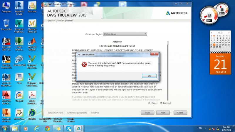

tipu_sultane
How to find that software that the DWG Trueview 2015 needs as prerequisite?
Why this software not required for AutoCAD 2014 during installation?
Share this post
Link to post
MSasu
That Framework is a library required to run applications developed in .Net; for AutoCAD 2014 was required a previous version.
You may find said library at Microsoft, free of charge.
