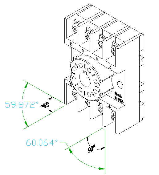

I am experiencing an interesting problem in Inventor!!!
Have you noticed when you measure the angles on your isometric views it is wrong! Instead of being 60 and 120 degree it's got a funny dimensions!!!
Please see below and the attached files.

I still have this problem unsolved!
To me it is a big problem. Just draw something in Inventor then export it to dwg file to see.

This is an internal error in Inventor and apparently nobody has noticed this yet!
I copied this from Inventor 2015 to AutoCad, and I also see a difference.

As noted on the AutoDesk Forum, the problem is with the projected ISO views.
If the baseview ISO Top Right is chosen, then you get nice square angles.
This isn't a big issue for me, but I find it interesting.
Thanks I just saw all of that.
It's fixed in Autodesk Inventor 2016
