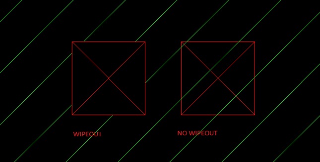

I'm not sure what the hide command is, but maybe a wipeout (WIPEOUT Command) would work better for you? A wipeout is like whiteout for cad drawing, you can use the draw order to set it in front of some objects and on top of others.
Here is an example.

Not sure, I just learned of this command myself past week or so haha! But I've already used it in a few applications, that vent, door, window, and my personal favorite railings!! No more trimming through the windows and doors! Its really easy, just type wipeout, or hit the button, then draw a polyline around what you want covered. Thats it. You can hide the frames if you want. Do wipeout, then f for frames, and off to turn off. Same to turn them on except on. Hope it helps!

Avoid using Wipeout, period. I am not saying the occasion will never come up, but try anyway. Especially in 3D modelspace, where a wipeout will become an object all of itself, and since it has a visible frame, it will show, and print. Sure, you will think you have the wipeout frame hidden by something, and everything is the way you want it, and then you rotate or pan your 3D view just a little bit, and there it is again.
Wipeout is nothing more than hanging a bedsheet between two houses on a clothes line. You cannot stop the back corner of a cube from showing through the front sides of the cube with a wipeout.
