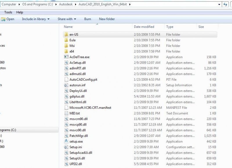

JD Mather Posted April 27, 2014 Posted April 27, 2014 1. Download install files (image attached) (burn copy of these part 001 of 002 and 002 of 002 to disk for backup) 2. Extract install files 3. Install program 4. Delete 1 and 2 from computer (keep backup of 1). 5. Run in 30-day trial mode for at least a couple of weeks to make sure all is running correctly, because - 6. You can only activate any particular license twice, so you want to make sure all is well before activating. Now activate by - 7. Click Activate (rather than Run as Trial) and enter your Serial Number and Product key (if not already entered at install). 8. Your computer will send an Activation Request Code to Autodesk 9. Autodesk will send an Activation Code back to your computer (8 & 9 happens in the background) and sends you a confirmation email of you Activation Code. 10. Create a Windows Restore Point (in case something goes wrong in the future) (which brings up the point - make a Windows Restore Point before beginning the install and turn off anti-virus and UAC during the install). As I recall download 2-3 hrs. Extract, I don't know - 30 minutes? Install, I don't know - 1.5 hr? Quote
Emboss 2014 Posted April 27, 2014 Author Posted April 27, 2014 [ATTACH=CONFIG]48456[/ATTACH]1. Download install files (image attached) (burn copy of these part 001 of 002 and 002 of 002 to disk for backup) Compare to your attached images, I don't have those 2 EXE files like you have, I only have that one file as shown on #8 Thread, that's weird. how did you get those 2 files? I looked in my download folder but can't find them. Quote
JD Mather Posted April 27, 2014 Posted April 27, 2014 I never use the Autodesk automatic downloader - I always use the Download with Browser option so that I know exactly where the files are going (the disadvantage to this technique is the download must be clean and uninterrupted, while I believe using the download manager can catch errors during download). I think you are pointing to the download manager rather than the actual download (but not sure as I don't have the time or interest to track down). It takes several hours to download - do you think you have done this? If so, search your C drive for the two files I named above. Quote
Emboss 2014 Posted April 27, 2014 Author Posted April 27, 2014 Ok, I found it in C Drive, It looks like there are many files inside. Thanks Quote
