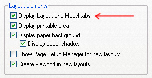

how do i retrieve?
Go to your "Options" dialog, "Display" tab, "Layout Elements" section and check the box that says "Display Layout and Model Tabs".

I'm having problem with new autocad LT 2009. I have drawing (drawn with autocad 2007), there supposed to have 3 pages of layout but when I opened it with LT 2009, I couldn't find any MODEL/LAYOUT toggle button and there are only 1 layout appear :huh:. can anyone who using new autocad 2009 show me where are those MODEL/LAYOUT toggle? i've tried to find it but no success :cry:
got it, thanks! :)
