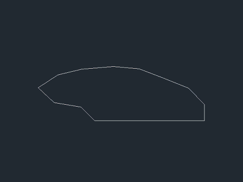

Maybe BREAK the PLine then re-close it?

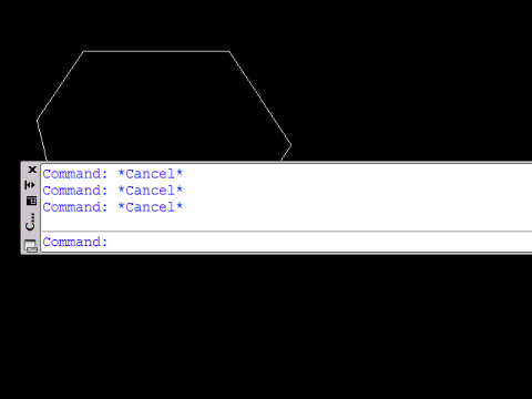

When doing "BREAK" how did you bring up the "first point" after selecting the object mine says "select second break point" straight away.
Nestly is using DYNAMIC INPUT, and has used the down arrow on his keyboard to access the available options scroll down list.
In this case FIRST POINT is the only option in the menu.
Right. When there are options within a Command, Dynamic Input displays a small arrow next to the command name. Pressing the "Down Arrow" on the keyboard will show those options in a clickable menu. I did that only for demonstration purposes, it's actually quicker to just press the "F" key within the BREAK command to activate the [F]irst point option.
