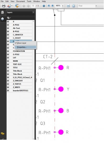

tipu_sultane Posted May 3, 2014 Posted May 3, 2014 Yes you can, but the only supported PDF file which have been converted from DWG to PDF format. You cant convert image file from camera or simply captured from print-screen button to DWG file. Your PDF should be similar to the image attached below. Quote
