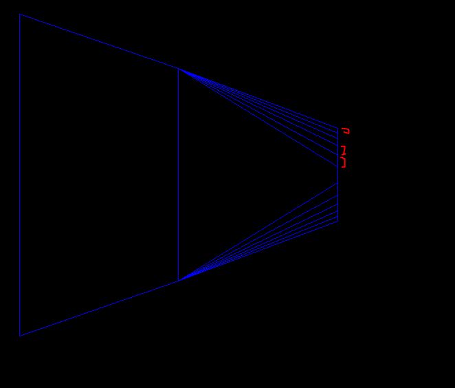

Sengna Posted May 1, 2014 Posted May 1, 2014 I am not sure what this called, i see a lot for HVAC duct detail drawings. i was wondering if there a rule or formular for the distance between each line (gap with my red mark), i found one of the drawing, i checked the dims: 1st gap was 3/8", 2nd 7/16", 3rd 1/2".....Is there any online source for my own reference that someone can suggest me? tried to google online but can't think of word to describe. Quote

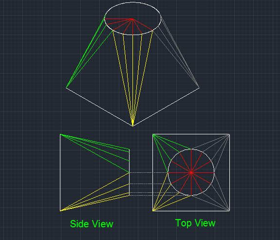

JD Mather Posted May 1, 2014 Posted May 1, 2014 That is called a transition piece (rectangle to round) development. Search for on the terms "developments" and "transition". A search should turn up many examples FIG 19.35-4.dwf Here is the layout of a general solution. Note that the correct solution is an arc length, then flattened out. You would take these from the top view as they are not true length in the view you have shown. Of course, with modern 21st century CAD tools, you simply model the finished part and the CAD tool gives you the Flat Pattern development. An in-depth analysis would show that the classical method is a "fudge" anyhow. Quote
rkent Posted May 2, 2014 Posted May 2, 2014 I have the feeling you want to know how to draw exactly what you have shown and not how to draw the development. You have shown a square to round transition and showing that on an HVAC drawing is meant as a representation of what is needed rather than showing the tradesman how to make it. As such you can just fake it and the fewer the lines the better, just enough to get the point across. The lines represent the bend lines that would be required to actually form the piece with more bends resulting in a more round opening. To determine the exact spacing you would draw a circle the size of the duct, divide the circle a number of times and project that across to a side view. Quote

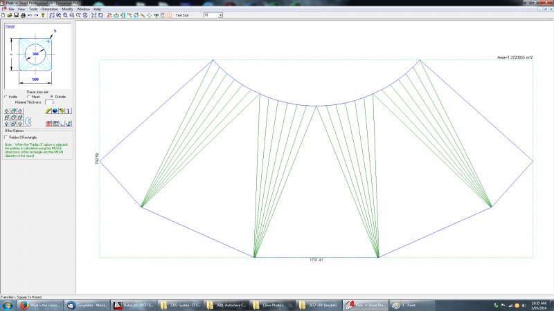

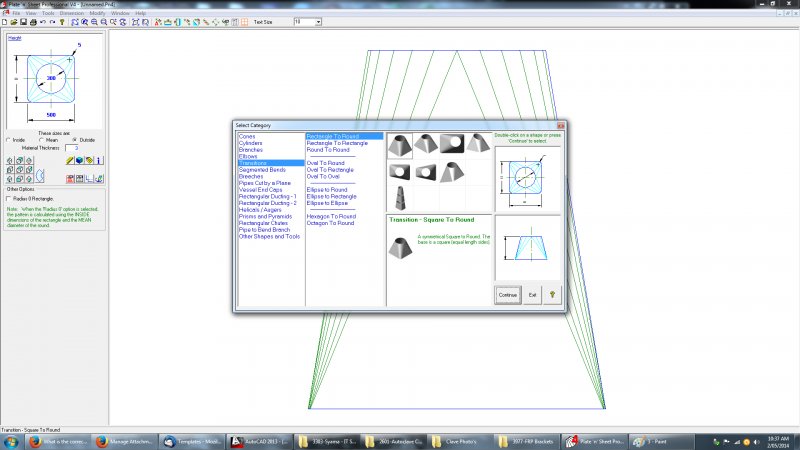

gazza_au Posted May 2, 2014 Posted May 2, 2014 Speak to the guys who will be pressing it up, they will let you know how many press lines they need. Quote
gazza_au Posted May 2, 2014 Posted May 2, 2014 As a fabricator we have programs to do this to save time.. Good luck Quote
Sengna Posted May 2, 2014 Author Posted May 2, 2014 As such you can just fake it and the fewer the lines the better, just enough to get the point across. The lines represent the bend lines that would be required to actually form the piece with more bends resulting in a more round opening. . I like that. Fake it until you make it LOl. Thanks rkent for showing me, very easy to follow. I was wonding what type of tool they use to bend this sheet metal in the shop. Quote

Sengna Posted May 5, 2014 Author Posted May 5, 2014 As a fabricator we have programs to do this to save time..Good luck [ATTACH=CONFIG]48593[/ATTACH][ATTACH=CONFIG]48594[/ATTACH][ATTACH=CONFIG]48595[/ATTACH] That makes your life much easier it n't it gazza_au Quote
gazza_au Posted May 5, 2014 Posted May 5, 2014 Yes Sengna it certainly does.. most of my stuff is laser,plasma or water cut so it's easy to just send them a dxf, let me know if you need a development done so you can compare it to your new skills :-) Quote
