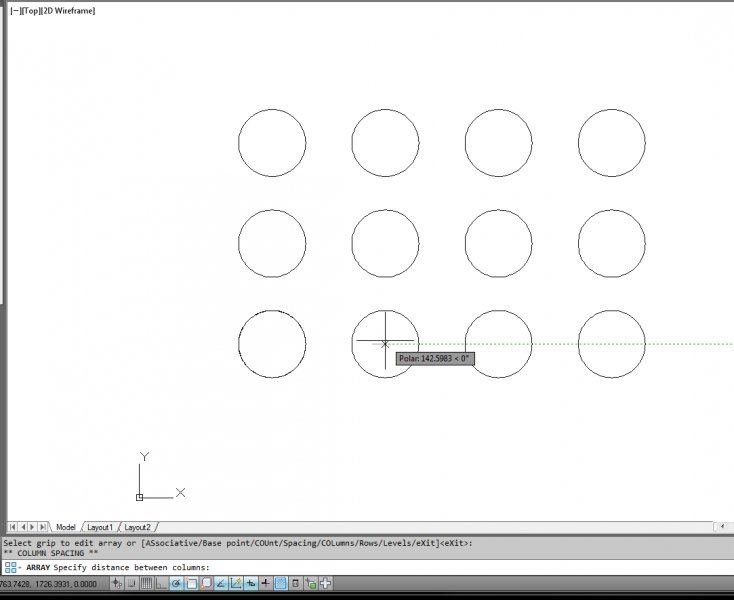

Oh wow! I did not know such function existed! Huh... What do I enter? I am stuck on multiple circle now, how do I govern the distance between each circle?
Do you have a link the to appropriate tutorial?
Screenshot 2014-05-06 21.08.09.jpg I tried entering my distance but it does not place the distance I want it to be.

Look at your command line instead of the screen. Do you see the various options available? Ex. - COLumns and Rows?
For assistance try using the built-in help by pressing the F1 key.
Or view this CADTutor tutorial about the different Modify commands...http://www.cadtutor.net/tutorials/autocad/modifying-objects.php
