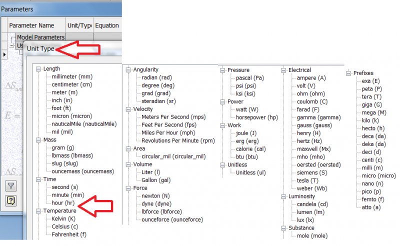

I can't find light years in Autodesk Inventor. Has about everything else I need. Guess I need to add that unit to the wish list.
Hmmm, doesn't even have year, but I guess the unit "year" varies, so it can't really be called a unit.
Seems like some of the area and volume units are undocumented in this list, but I know I can retrieve those....
