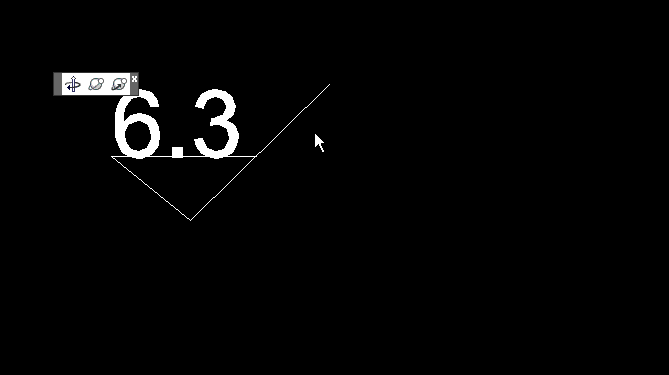

I need a routine for Z axis to zero, Support all object, block ,attrib block ,dynamic block.
Thanks for any help !

NO,test it z0.dwg
There is an easy one routine. but not support any block.
;;(HH:vlaZto0 (ssget))
