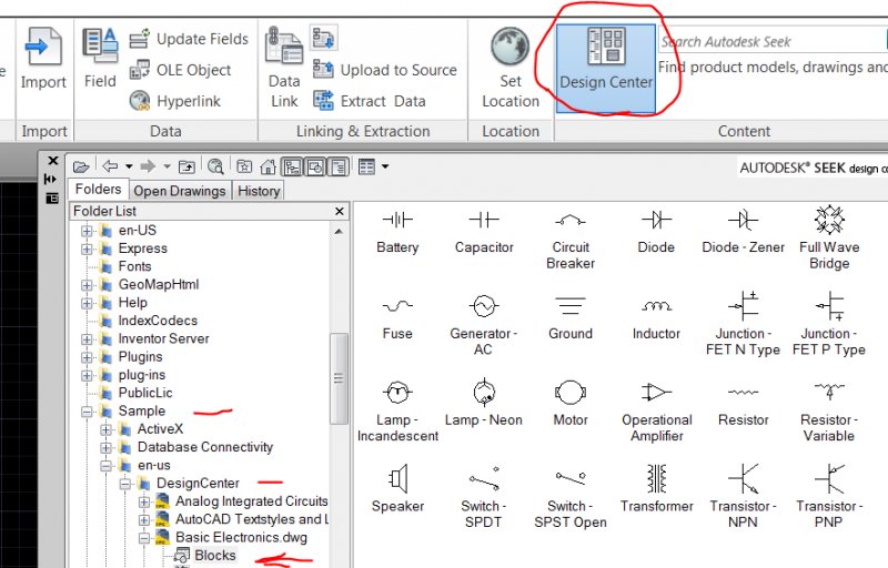

Most of these schematic symbols are already created for you as blocks within your Design Center in AutoCAD, simply a matter of placing the blocks and connecting them together.
This should have been covered in your class.
In fact, you should have been shown how to add attributes to your blocks for an assignment like this.
On your Insert tab>
There is more than one file of these blocks.
Too bad I didn't see this thread 3 days ago. Work fast.
I don't think the student will find the blocks shown by using the Design Center and even if he open his Tool Palettes and looked there (on the Electrical tab) he still won't find all the symbols used in the diagram. This is a good opportunity for a student to get acquainted with the BLOCK command in my opinion.
I have my students start with these blocks and edit them for our needs - a good way for starting with blocks.
By the end we are embedding Attributes and Extracting the attributes to tables.
Several (one of them a freshman) passed the AutoCAD 2014 Certified Professional exam a couple of weeks ago.
I think a student should know how to create a block from scratch. Once that is covered then you can move on to the use of BEDIT. After that you introduce attribute creation and such things as attribute extraction and the use of BATTMAN.
