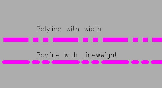

How have you made your thick polylines? - with width or by lineweight?

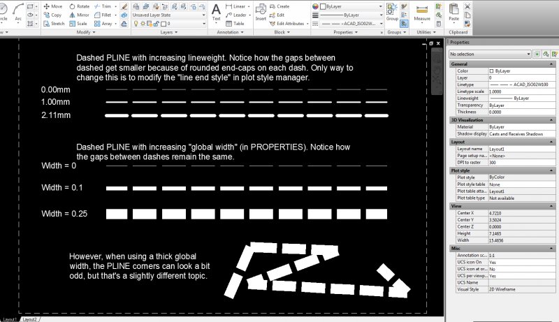

This seems to be the best solution, indeed! Use PLINEWID to set the width of new lines; or select an existing line and change the "global width" in PROPERTIES.

Also, this image better explains what I'm talking about. Hope it's helpful to someone at some point. :lol:
