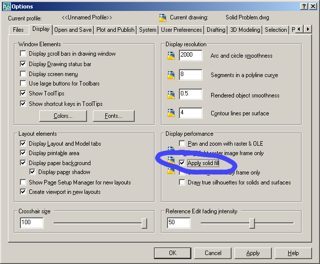

rkent Posted December 5, 2008 Posted December 5, 2008 Usually one of these: UCS set to World. FILLMODE set to on. SHADEMODE set to 2D. Quote
Steve.G Posted December 5, 2008 Author Posted December 5, 2008 my file has those settings as listed. ..........still need help......... Quote
GhostRider Posted December 5, 2008 Posted December 5, 2008 when I open your file here your arrowheads and the scale are filled in.. your not in 3d hidden visual style view are you? is your text solid filled or hollow also? Quote
Steve.G Posted December 5, 2008 Author Posted December 5, 2008 if you're refering to shademode, I have it set here to 2dwireframe Quote
