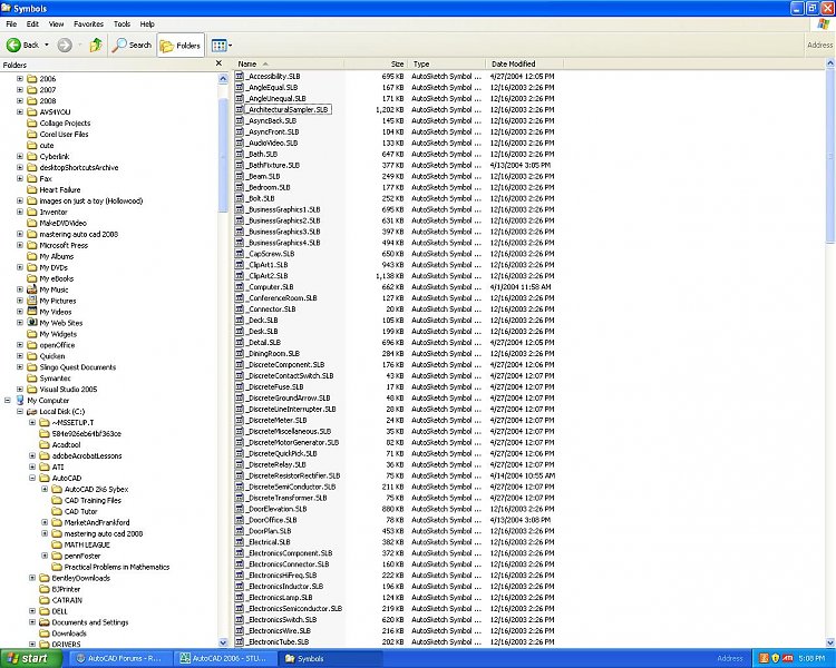

I have thousands of symbols in Autosketch 9, and would like to inport them to AutoCAD 2006. Any ideas? I currently have to drag them all onto seperate sheets.
Thousands? Hmmmm. Normally I'd say put them in a drawing then use Design Center to open the drawing. Then I would drag-n-drop them on a tool palette(s). I guess these symbols must cover quite a range of disciplines? What would some of them be?
I have attached a file and a bitmap that I created last night. I don't remember from what SLB whence they came. The symbols library is from Autosketch 9.
I-Beam II.DWG
Not sure but a SLB is a slide library file its made up of 1 or more bitmap images. Your Autosketch may save the equivalent to a drawing as a SLB file. Could you please attach a couple of slb's here.
There is free software out there that will split up a SLB into individual files and its run from the command line so you could convert thousands fairly easily (will discus how later) but they will be bitmap images.
In response to your recent request, I have selected two random files and installed them into a zip file for you. Thank you for the info.
symbolLibrary 001.zip
