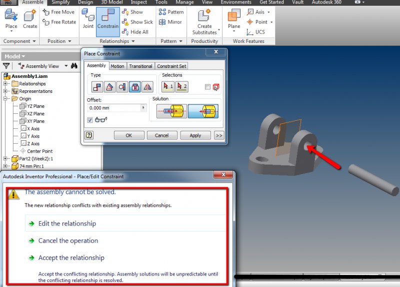

the assembly cannot be solved (the new relationship conflicts...) What's that?
i m working on my first basic assembly, i don't know if i did it right, all i want is just to insert the pin into the part, i used the insert constraint, i picked first and second Geometry and the message popped up. Please any suggestion what am i missing here? Thanks.

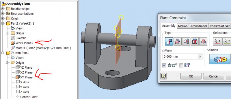

Notice that if I expand the Relationships folder (as suggested earlier) that there are sick constraints (yellow triangles).
Right click and delete these sick constraints.
Notice that there is a constraint with a 75mm offset.
Right click and delete this constraint.
Notice that there is a workplane right smack in the middle of the pin.
Notice that there is a workplane right smack in the middle of the bracket.
Logic would seem to indicate that these two workplanes should be mated to center the pin in the bracket.

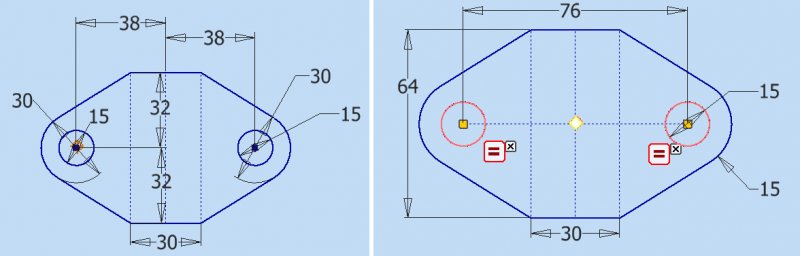

Notice that you are doing too much work.
Use symmetry in you model by placing the origin at the center of the part.
You can reduce the number of dimensions and do not need to create that extra workplane.
Use equal (=) constraints to reduce dimensions.
Place dimensions that can actually be measured in the real world on the real part.
it's very difficult for me to figure out which dims needed in the complex geometry shape, apply extra dim would give me the warning for over constrain, this is something that i will need to overcome when learning inventor. thanks for showing me this trick..
