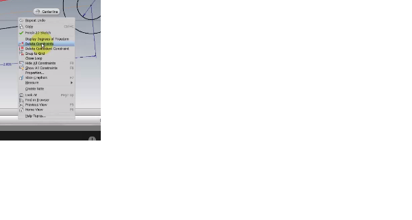

I cannot see the "Delete Coincident Constraint" command on my menu in Inventor 2015 (like the snapshot of a footage from youtube)!

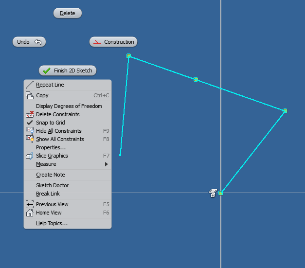

see below
You must have only one line selected (highlighted).
Is there any way to remove all the constraints plus Coincident Constraints?

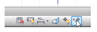

Relax Mode
Will allow changes to sketch even if it is fully constrained. It can also be used to quickly remove unwanted constraints.
