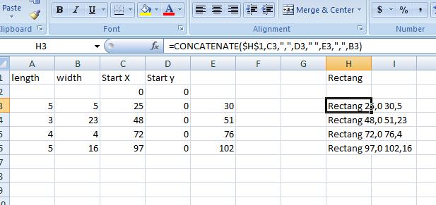

Back to problem if using excel then just start at a point like 0,0 and keep adjusting the X value including a gap and you will end up with a single row of rectangs. Just copy the right column to command line
[ATTACH=CONFIG]49299[/ATTACH]
