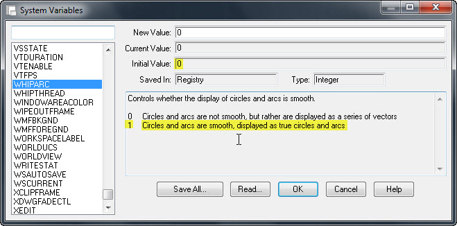

I understand that the OPs quest has already been answered by setting the VIEWRES variable, but there is also one more setting that could come in handy.
I briefly mentioned it in the following post [HERE]
Whereas the VIEWRES is saved in a drawing, the WHIPARC variable is saved in the registry and by default is turned off
It isn't a fix-all to fixing "blocky" curves though - There is an issue that we ran across when this setting was turned on with ACAD 2013 and using XREFs. ARCs and CIRCLEs in XREFs would appear "brighter" or more vibrant compared to other objects on the same layer (color).
Its worth a try.
