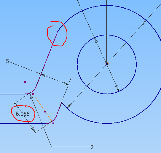

Heres a part I drew recently, I don't think any of the sketches are fully constrained. To be honest until now I haven't really checked to see if a sketch is fully constrained, I have just created a sketch and constrained and dimensioned what I thought was necessary.
If you can take the time to demonstrate what I have done wrong that would be brilliant, thank you!

As I suspected - your part does not match the real world or logic.
I would expect the design intent is for Tangency between the arc and the angled line.
I would expect the material to be uniform thickness sheet metal. The outside of a bend radius should be the inside radius (2mm) + the thickness of the material (5mm) = 7mm. So, because you used the incorrect radius for the outside of the bend - the material is not uniform 5mm thickness.
